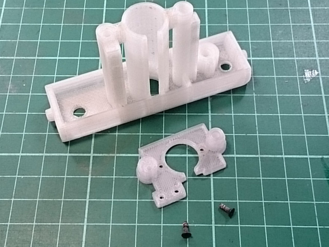

[TD] Before Assembly
 Please to read "How to work with 3D printed parts" and to clean and trim parts.
[/TD]
[/TR]
[/TABLE]
[TABLE=width: 640]
[TR]

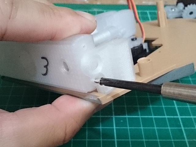

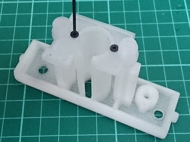

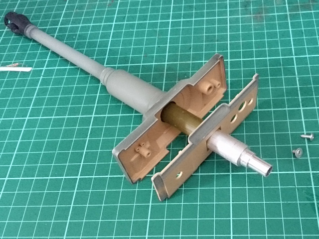

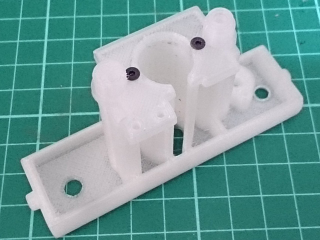

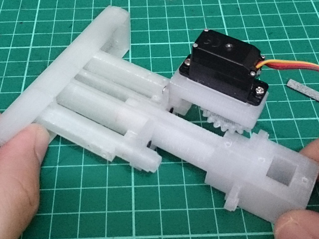

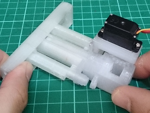

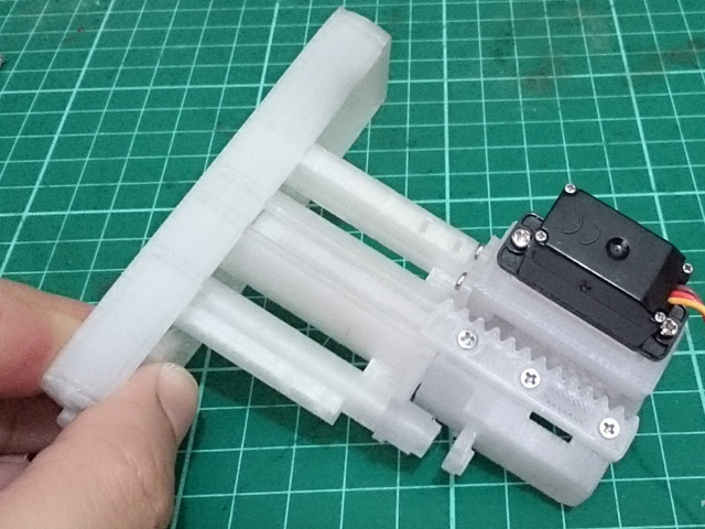

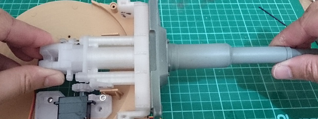

[TD]Gun Recoil
Remove gun and mantlet from Tank

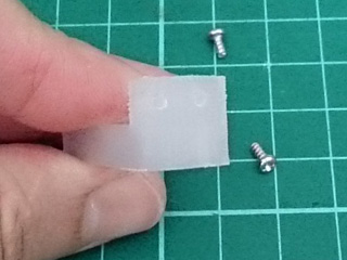

 Get  A7, A8 and MA6
Bolt A8 to A7 with MA6
smooth inner surface of A7 for barrel movement.

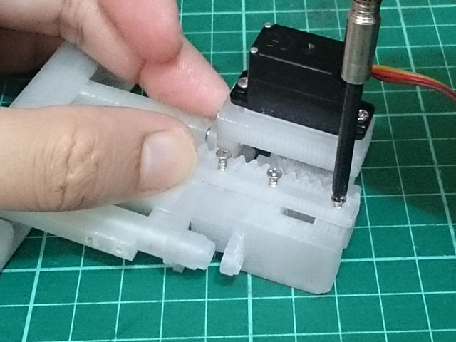

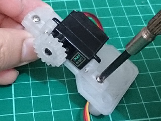

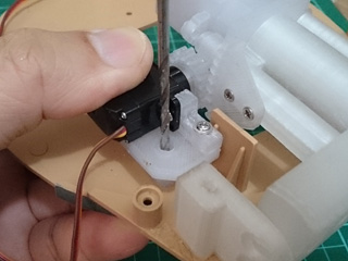

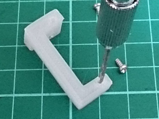

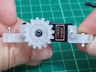

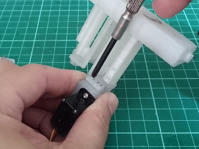

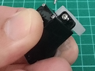

Drill screw hole on A6 with 1.6mm drill bit

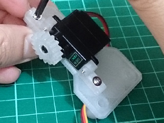

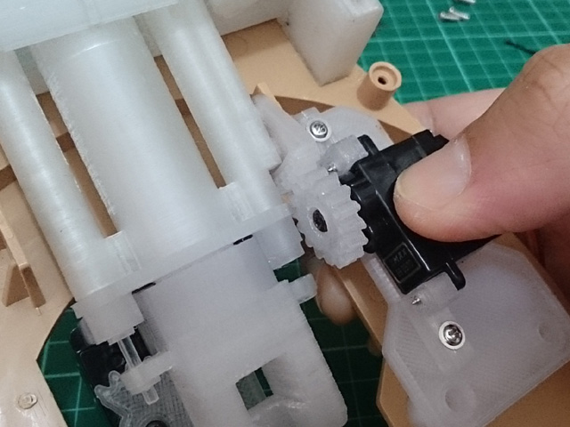

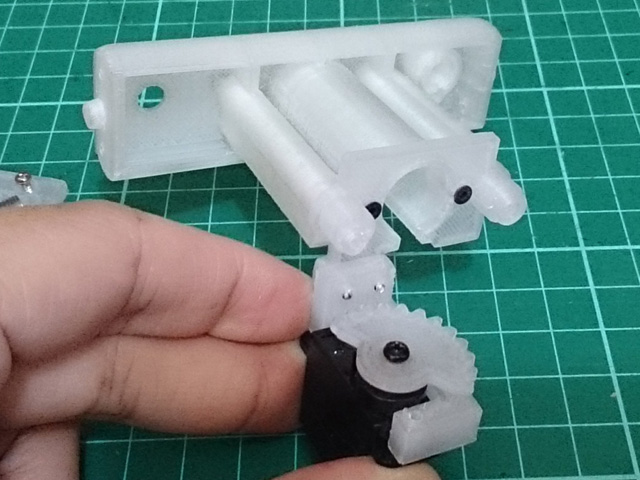

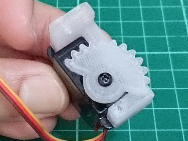

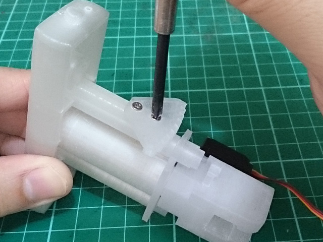

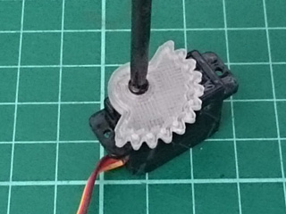

Set recoil servo direction to Normal, plug servo to TK board to set right position of servo output shaft, then to fit recoil gear to servo, use black screw in servo bag.

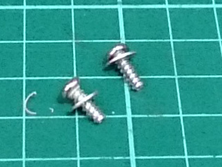

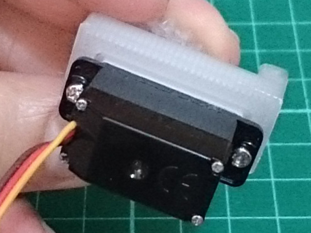

Fit  servo to A6, use Tapping screw in servo bag

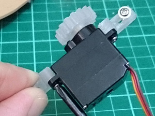

To view of recoil servo assembly, Notice the angle of gear
Bottom view

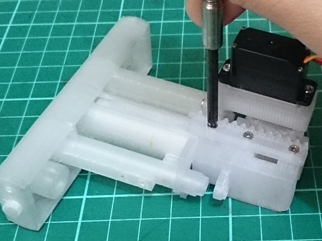

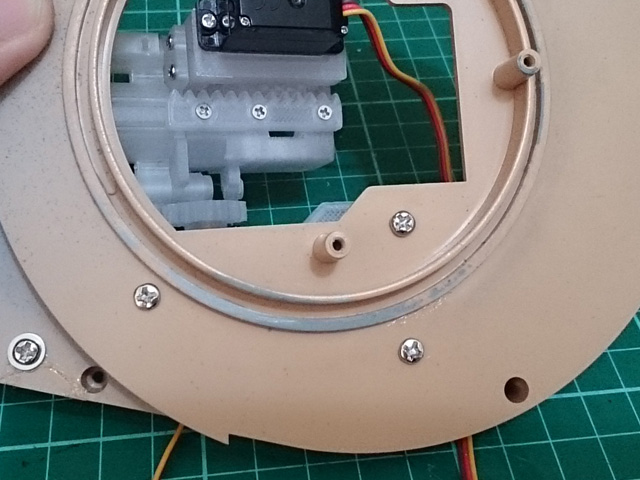

 Fit recoil servo assembly with MA2

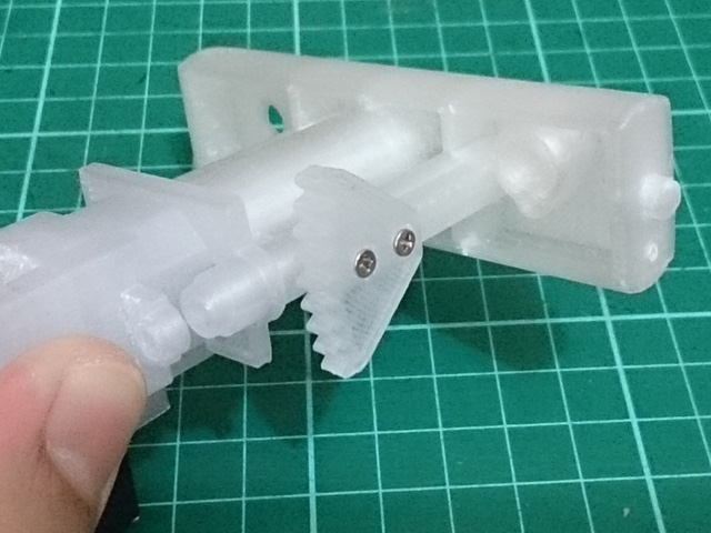

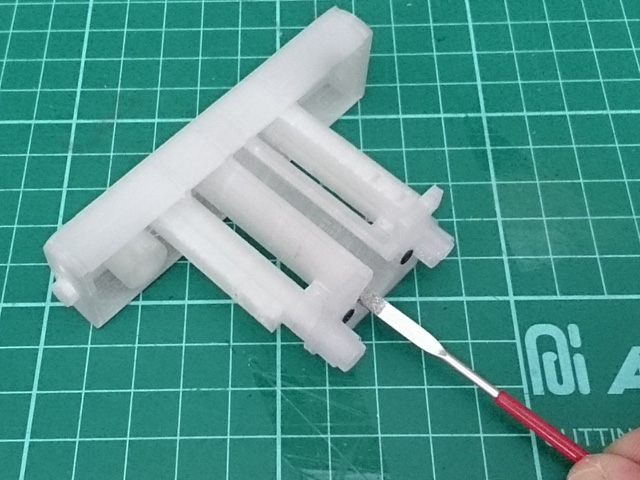

Insert A1 ( also smooth contact surface between A7 and A1 so that they can move smmothly)

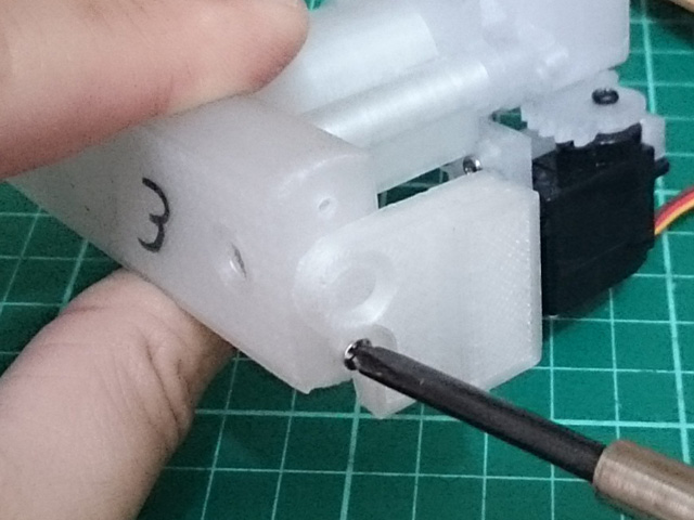

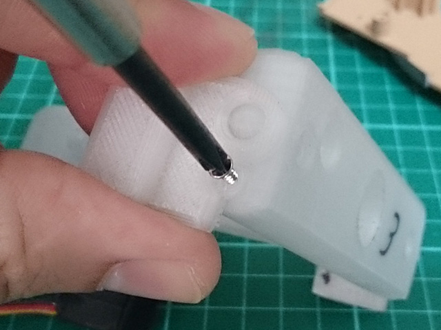

Bolt A3 to A1 with MA3

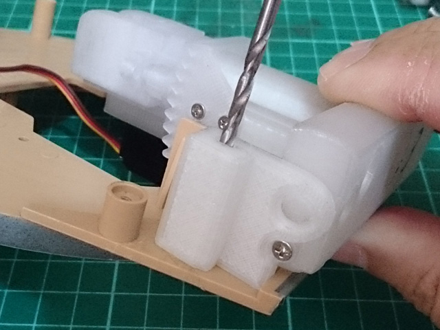

Fit A9 with MA3

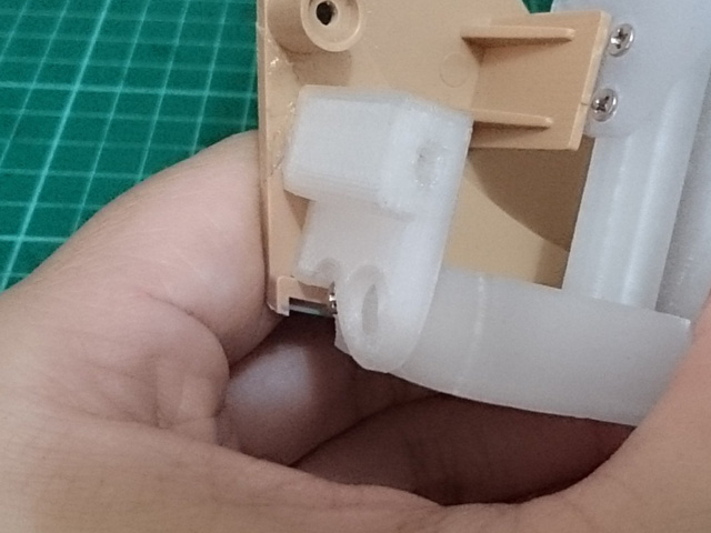

Fit A13 and A14 to A7 with MA3

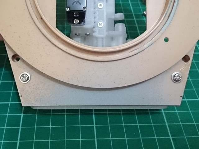

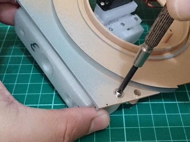

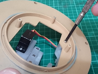

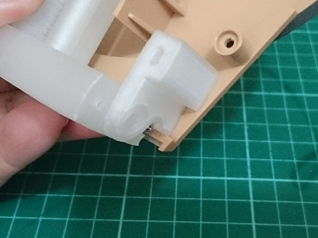

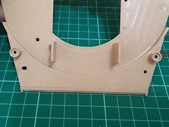

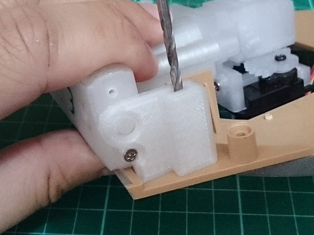

Put tunnion to turret lower hull, align it as picture
Use 2.6mm drill to make hole
On both side.
Then use 3mm drill to expand hold to 3mm
Insert MA6 to MA7
Bolt A13 and A14
Remove screw.

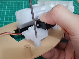

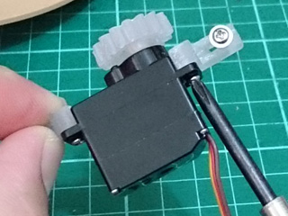

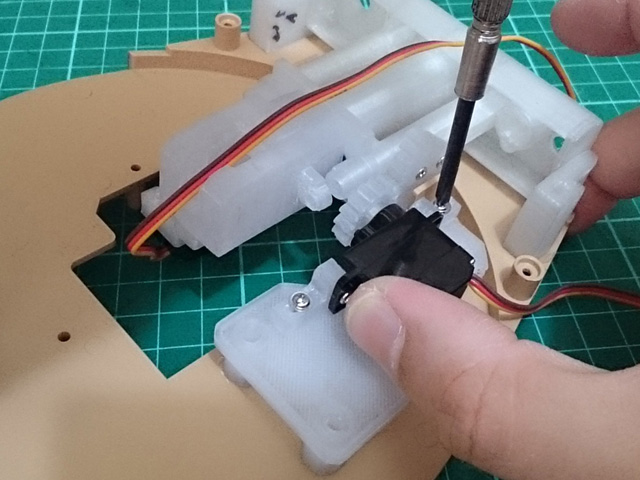

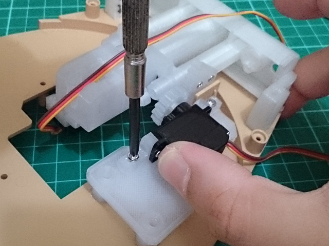

[TD]Elevation Servo

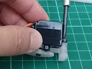

Fit A10 to Servo, use the black screw in servo bag
Fit servo to A12, use tapping screw in servo bag
Insert MA4 to A12
Install servo to servo stand with MA4 screw, not too tight, the slot on A12 allows servo can moves horizontal for gear gap adjustment.

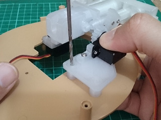

 Put servo assembly on turret lower floor
 Use 2.6mm drill to make hole for MA6
Use 3mm to expand hole to 3mm, the bolt servo assembly ti turret lower floor.
Push servo to minimize gap then to fasten servo.

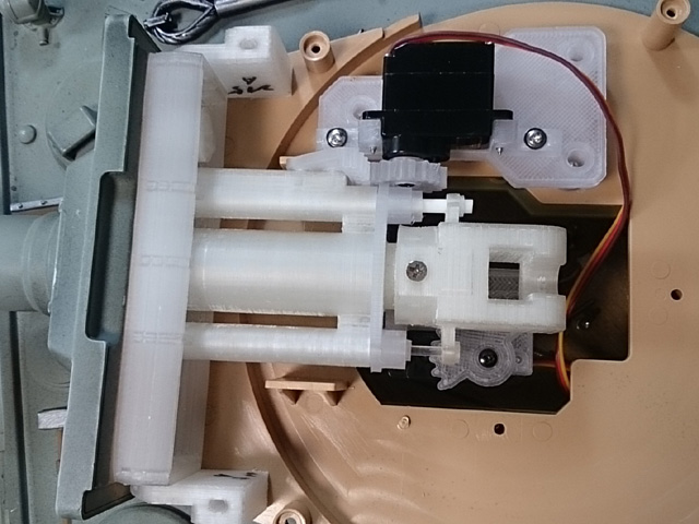

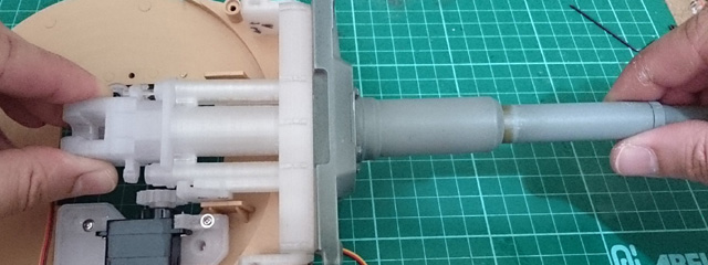

[TD] Final Assembly

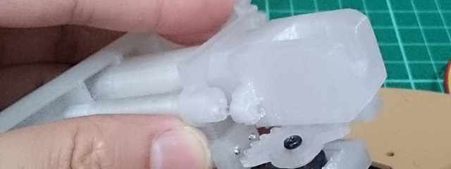

 Insert gun barrel
 Push it to the tip of A1, A1 is designed to fit gun barrel closely, no glue is needed.
 Insert 2mm plastic beam (from Tamiya) for declaration, 3mm round beam in other side
Apply some ABS cement to glue.
 Done!
